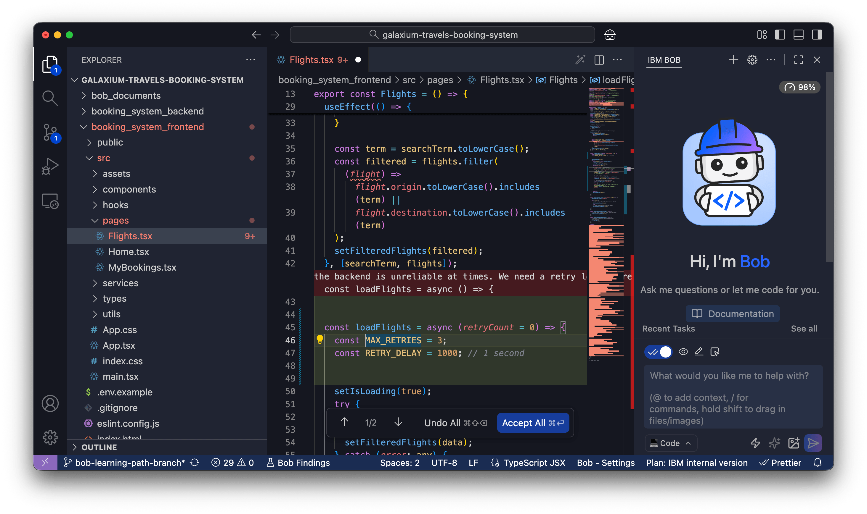

Use literate coding
The Galaxium Travels back end is unreliable and occasionally gets timeout errors. Instead of rewriting the code from scratch, you can use literate coding to wrap the specific block of code with retry logic.
Open the file
Open the booking_system_frontend/src/pages/Flights.tsx file.
Position your cursor
Click into line 43.
Write your instruction
Enter the following natural language instruction to describe the desired change on line 43:
The backend is unreliable at times. We need a retry logic here
Generate the code
Click Generate to produce the modifications.
Bob presents changes in a diff view interface. The highlighted red text shows what code is removed and the highlighted green text shows what code Bob adds.
Accept the changes
Review the changes and click Accept All to apply them.
You have added a retry loop to resolve timeout errors in the Galaxium Travels web application.
