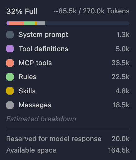

Hover over the token usage indicator in the top-right of the chat panel to see a breakdown of what is consuming your context window:
| Category | What it includes |
| System prompt | Bob's core instructions for the session |
| Tool definitions | Built-in tool schemas and connected MCP tool definitions |
| MCP Tools | Instructions and descriptions for tools provided by connected MCP servers |
| Rules | Custom instructions from project and mode rule files (for example, AGENTS.md or .bob/rules-*) |
| Skills | Instructions from skills Bob loaded for the conversation |
| Messages | Your prompts, Bob's replies, and tool activity in the conversation. This is the transcript counted as tokens. |
@ mentions, command output, and tool results all count toward Messages. File contents do not appear as a separate line.
Under Estimated breakdown:
- Reserved for model response: Tokens held back for Bob's next reply (typically 20.0k).
- Available space: Remaining free tokens.

Fixed categories consume tokens before you begin working with Bob. On the Galaxium Travels sample project, even a prompt as short as "Quickly say hi back." totals approximately 8.5k tokens. Most of that is Tool definitions (5.1k), System prompt (1.5k), Rules (830), and Skills (454). Only 590 tokens are in Messages.
Bob re-sends the full overhead stack on every prompt. Adding more MCP servers or loaded skills increases MCP Tools, Tool definitions, and Skills before you type a single word.

The token usage indicator shows the percentage full and a used/total fraction against the 270,000-token cap. Hover over it to see the context window breakdown. Check which category is growing.
