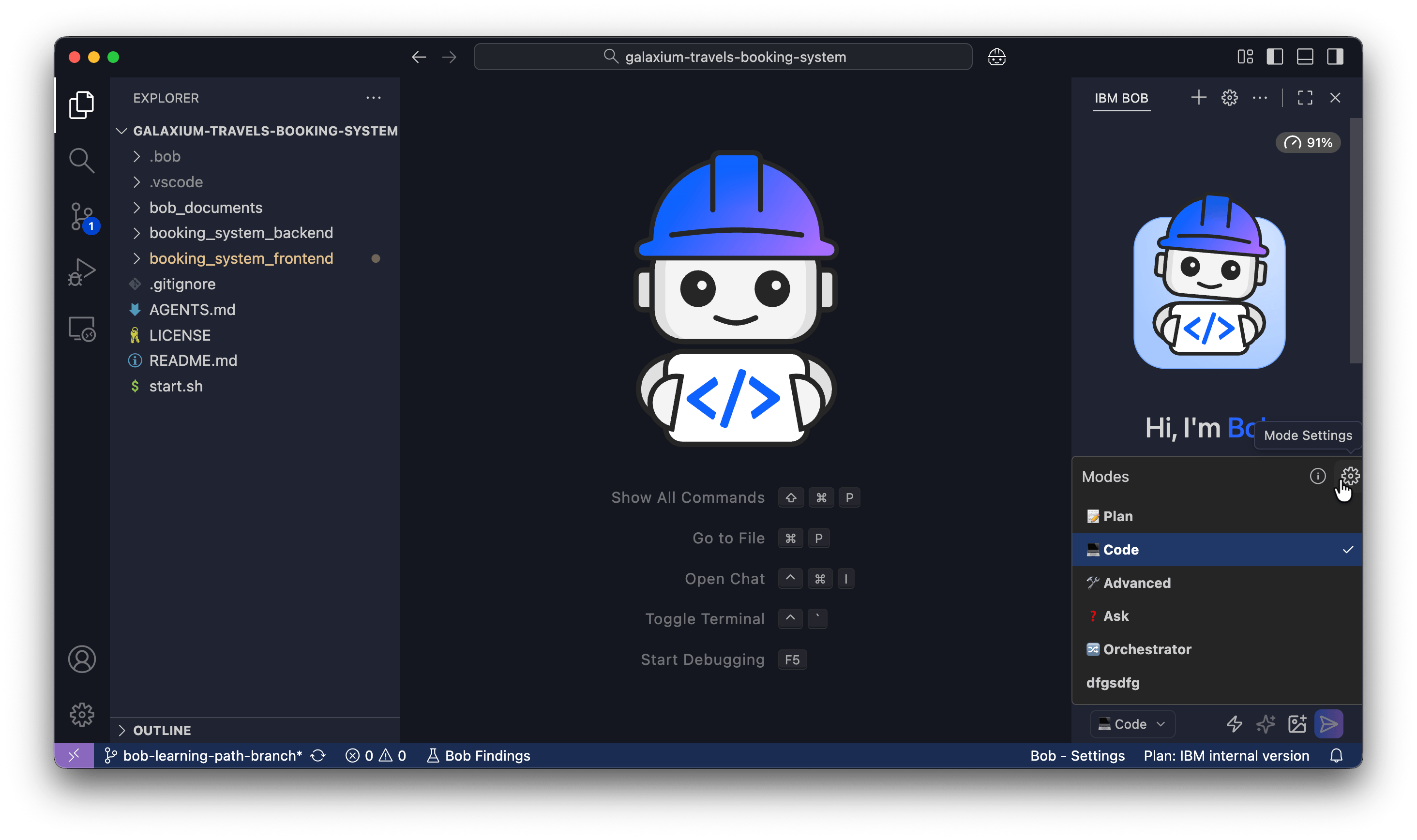

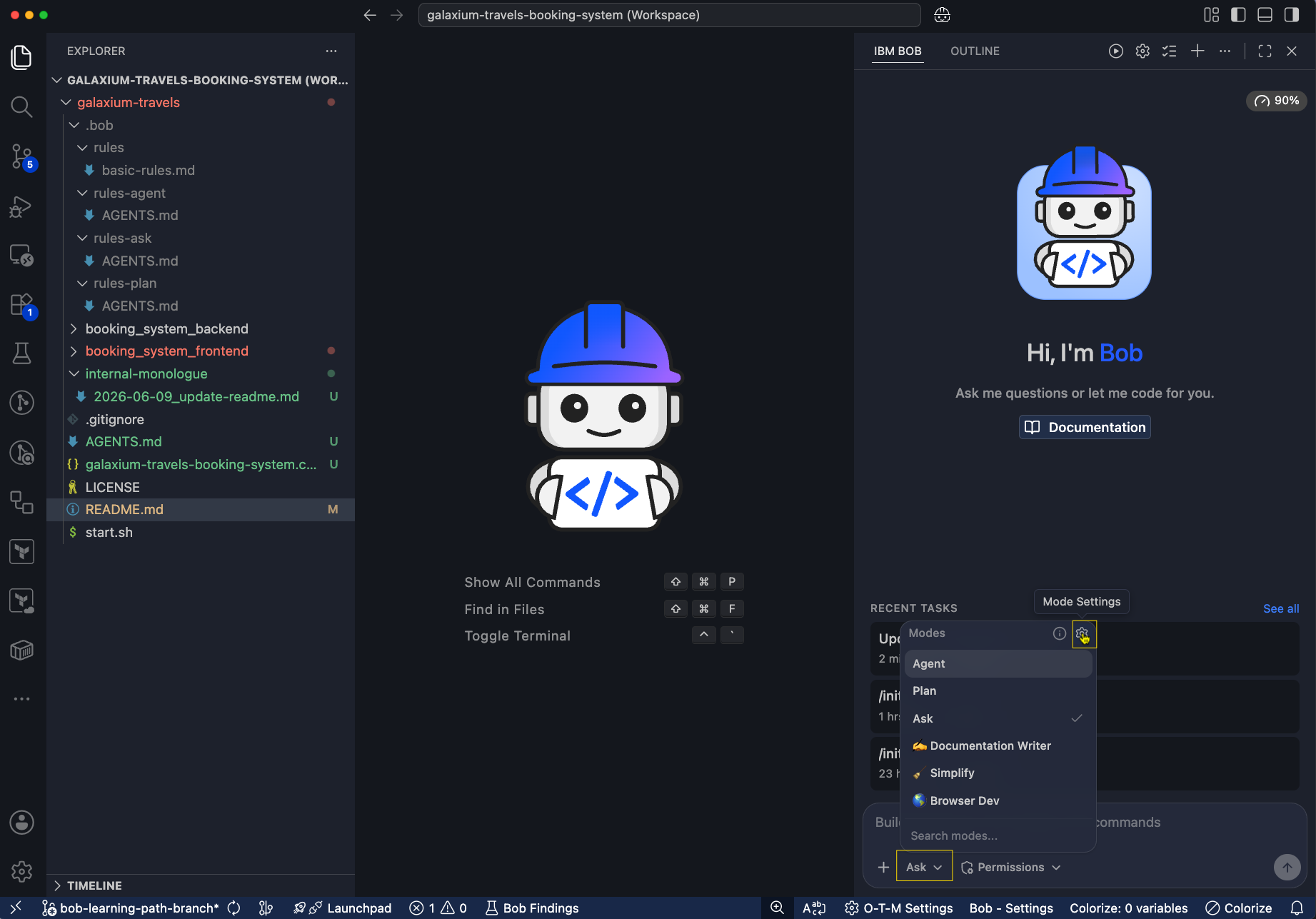

Open mode settings
In the Bob IDE, open the mode selector and then click the gear icon to open mode settings.
The gear icon in the Modes selector opens mode settings

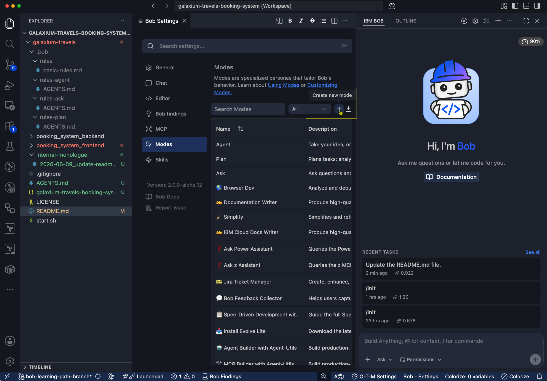

Create a new mode
Click the + icon to create a new mode.
The + icon in the Modes selector opens the Create new mode dialog

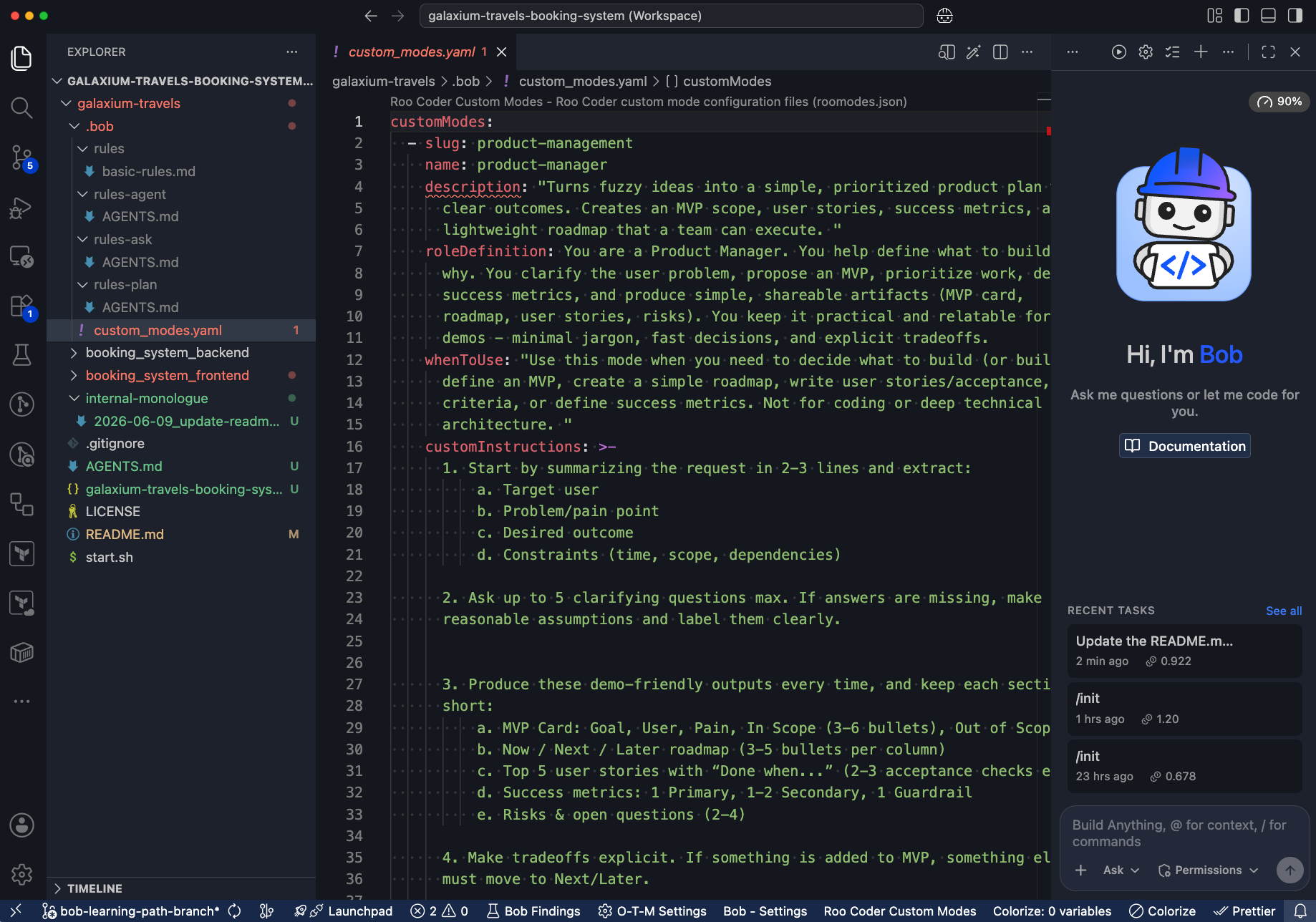

Bob creates a custom_modes.yaml file in .bob that contains the product manager mode configuration. You can edit this file to make changes.
The custom_modes.yaml file created in the .bob folder
