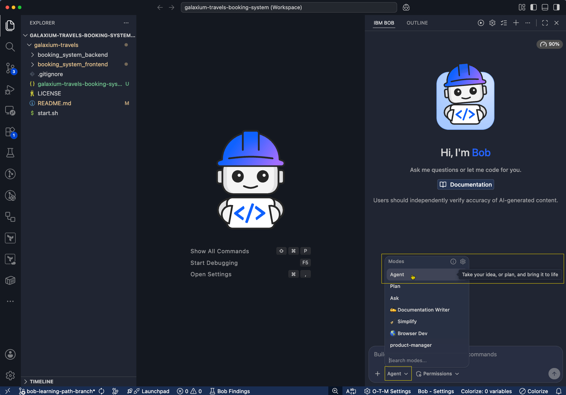

To initialize the project context, navigate to the Hi, I'm Bob chat interface in Bob IDE. Switch to Agent mode on the bottom of the sidebar.

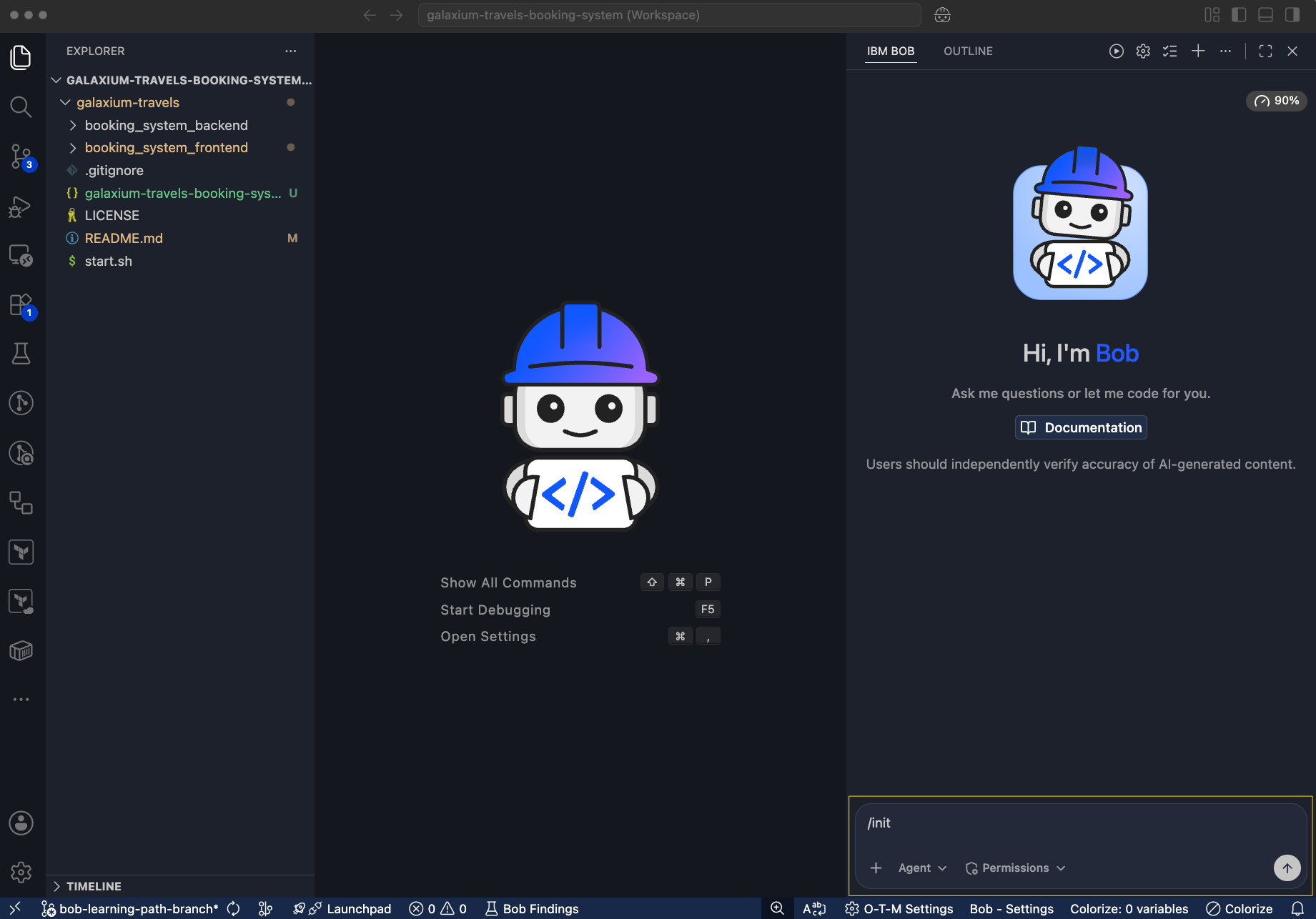

Enter the /init command in the chat interface. If you have auto-approval disabled, Bob asks your permission to read files and write the AGENTS.md files.
/init

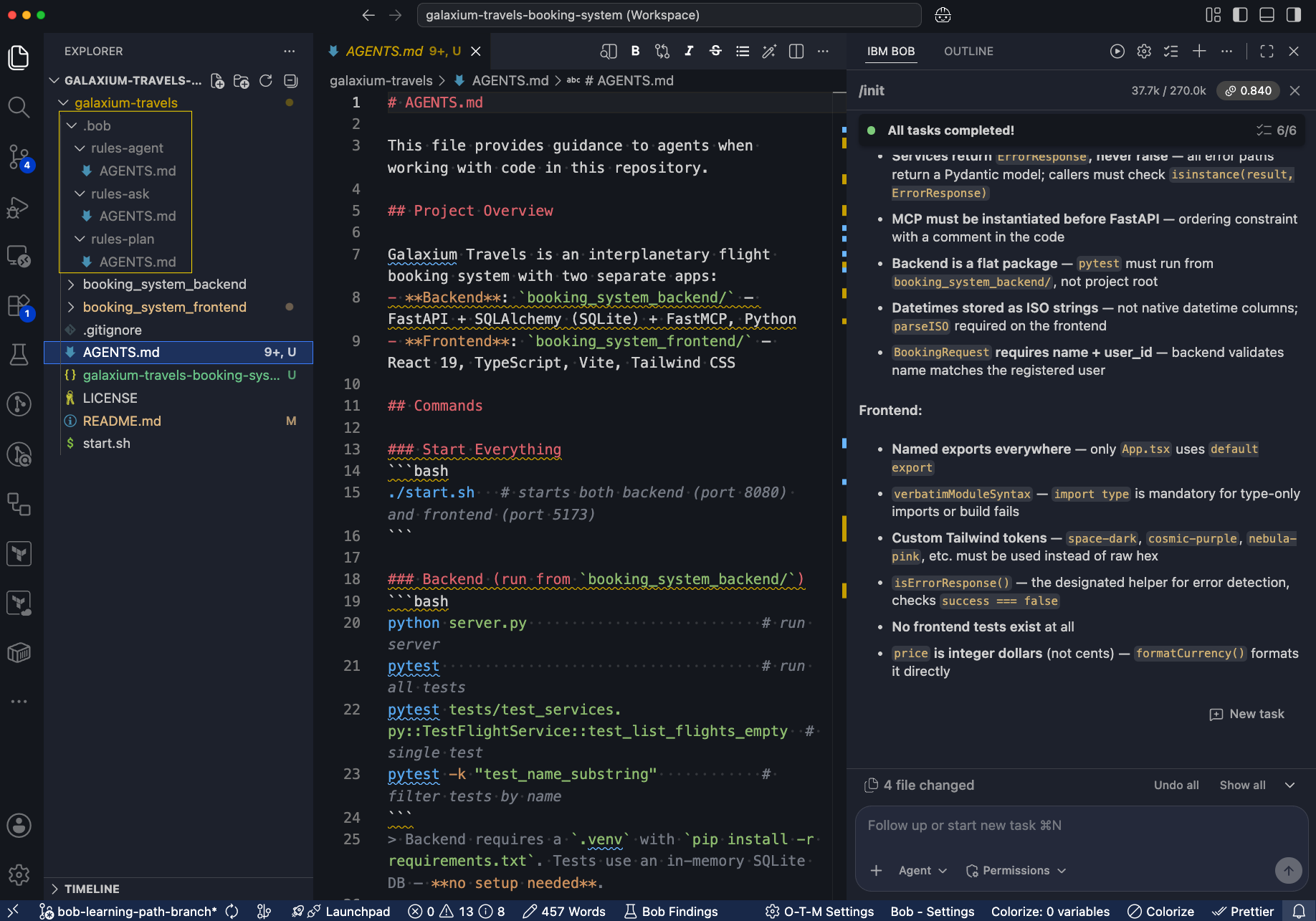

Bob reads the relevant files in the project. Bob then generates the main AGENTS.md file in the Galaxium Travels root directory. Bob also creates a .bob folder that contains an AGENTS.md for each mode.
Explore AGENTS.md files
The AGENTS.md files function like onboarding documentation for Bob. AGENTS.md is a concise, actionable summary that provides everything Bob needs to understand the project's structure and conventions.
You can locate the main AGENTS.md file at the bottom of the Bob file explorer on the left-hand side. Open the file to read its contents.

Mode-specific AGENTS.md files
In addition to the main AGENTS.md in the Galaxium Travels root directory,
/init generates mode-specific context files in the .bob folder for each
built-in mode. Each mode-specific AGENTS.md extends the main AGENTS.md with
context relevant to that mode's purpose. The following table lists the
mode-specific AGENTS.md files:
| File | Mode |
.bob/rules-agent/AGENTS.md | Agent mode |
.bob/rules-plan/AGENTS.md | Plan mode |
.bob/rules-ask/AGENTS.md | Ask mode |
The Plan mode context emphasizes architectural conventions, while the Agent mode context highlights file structure and naming patterns.
