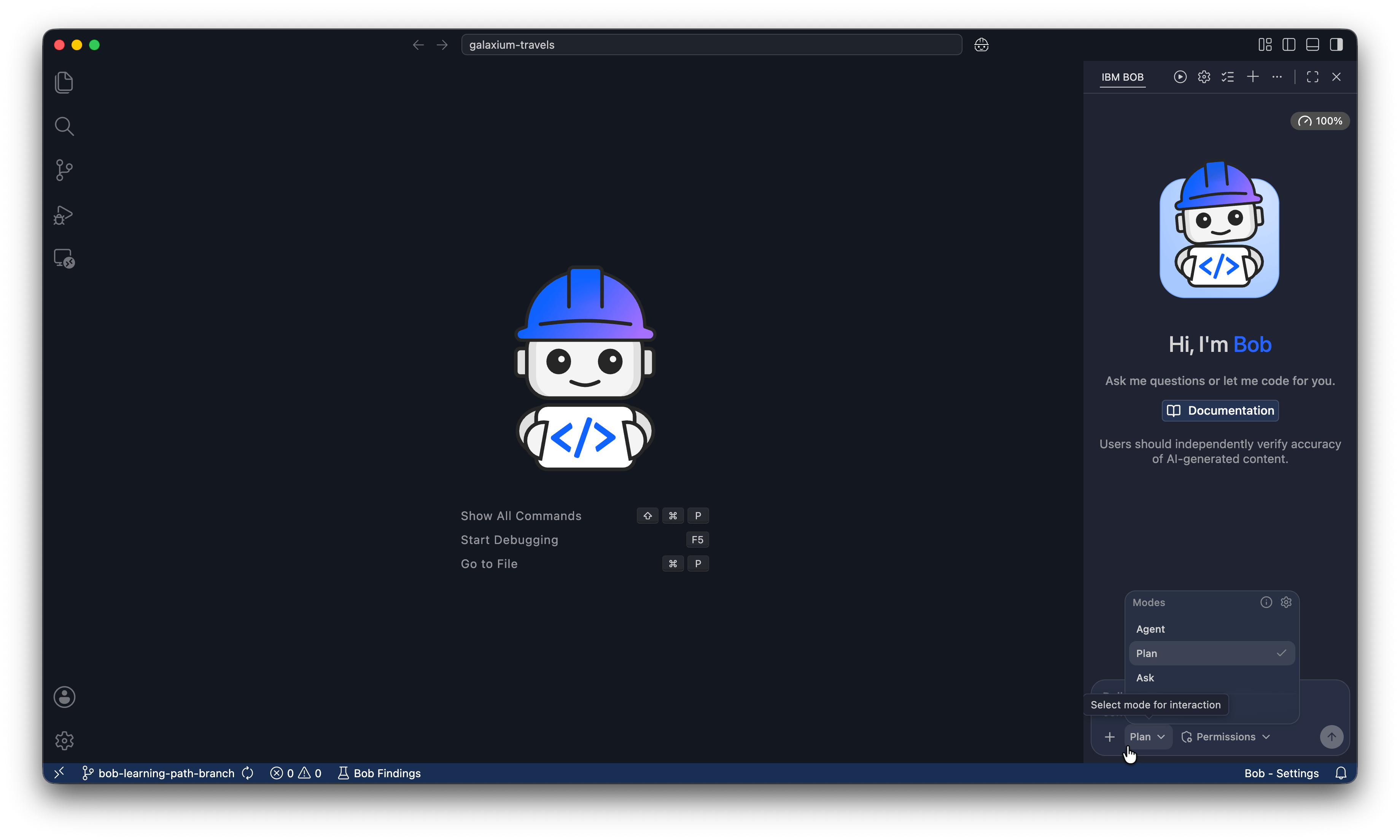

Use Plan mode to create a plan that Bob follows when implementing the seat classes feature.
Open the agentic chat sidebar
If the chat interface is closed, open it by clicking the Bob icon beside the navigation bar or use the shortcut Option + Command + B (Mac) or Ctrl + Alt + B (Windows).
Create the plan
Run the following prompt in the input field. The prompt applies the scoping principles from the How to write a Plan prompt section: names the layers to change, sets a file count limit, excludes the admin dashboard, and states an acceptance criterion.
